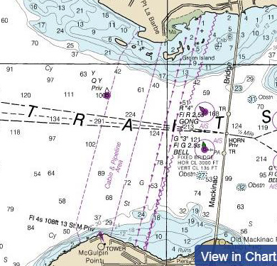

Jon Paul wrote:The cable/pipeline area is within 1 mile west of G3 and R4 which are the buoys marking the shipping channel west of the bridge. NOAA chart 14880 clearly shows this to be an with average depths of 100'-120'. The area of 200' area is more than a mile west of the lines.
Jon Paul. I'm certainly not trying to argue or question your local knowledge, but doesn't Enbridge's Line Five cross from Point la Barbe to McGulpin Point, which is slightly further west than the electrical cable? If so, chart 14881 seems to show a sounding of 224 feet within that area and one of 291 feet just outside the pipeline area.
Thanks for the updates. The Coast Guard and the various State agencies seem to be keeping pretty tight lipped, perhaps rightfully so since this may have legal or even criminal ramifications.

The cable/pipeline area is within 1 mile west of G3 and R4 which are the buoys marking the shipping channel west of the bridge. NOAA chart 14880 clearly shows this to be an with average depths of 100'-120'. The area of 200' area is more than a mile west of the lines. LCA courses funnel at those 2 buoys and that was where the track through the ice had been made which was clearly evident on the satellite photos I've seen and also saw myself as I crossed the Bridge several times during that week. There would be no rational point to deviating from the channel which held the track.
A salvage team is currently here and first day weather permitting an ROV will do an in depth survey of all utility lines and pipelines. Divers are part of the salvage team and will assist with the ROV but due to a 7 knot current, water temperature, wave conditions and roving ice, they will be limited to surface action.

Guest wrote:If the water there is 100' or more deep how could it be ice damage to something laying on the bottom?
The shipping channel is 100' or more in depth. To cross the Straits the utilities go from a depth of only a few feet to over 200. I haven't seen a description of where the damage occurred, but it wasn't necessarily in the shipping channel. It could be close to shore, even if it is an anchor or hull strike. Ice goes wherever it wants to in the Straits and vessels don't always stay where they should be.

Guest wrote:How deep is the water where the line is laid?
The shipping channel in the pipeline area is on average 100' - 120'.
