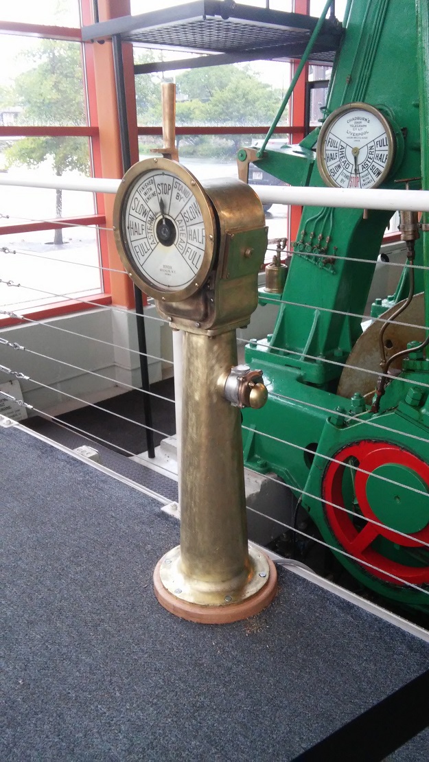

That is so cool that you have it operating via a functional Chadburn!

Chief Wawatam steam engine display in Manitowoc
The bow engine from the Chief Wawatam rail ferry was put into the Wisconsin Maritime Museum in Manitowoc, Wi back in 2005 and I put electric motor control and a lubrication system so that the engine could rotate for the public display. At that time it was controlled by a touch screen resembling an Engine Order Telegraph (Chadburn). Over the years we have had multiple computer failures and the museum wanted to put a real "Chadburn" in command of the engine.
Yesterday that vision was finally realized and is now in operation.
There are 3 speeds "Ahead" and "Astern" (engine reverses) as well 3 stop positions (Stop, Finished with engines, and Standby) that can be actually operated by the chadburn.
