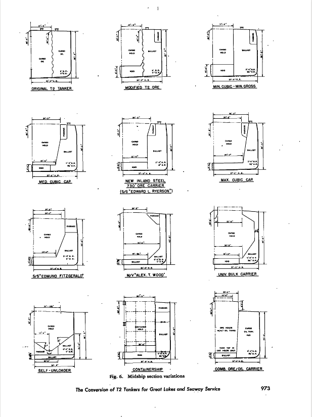

Isn't the bottom of the cargo hold raised during a self-unloading conversion anyways to accommodate the tunnel? I think the primary problem in this case is limited cubic capacity due of the Ryerson's cargo hold that is optimized for the carriage of iron ore. If I recall correctly this constraint is due to larger than normal ballast tanks but I may be wrong. Is it possible that a conversion not involving the sloped sides of the cargo found in the cargo holds of most self-unloaders would minimize the loss of cubic capacity? I don't know how close to the hatch coamings the Ryerson loads taconite too but I would guess that it would take up more volume than in a conventional ship designed with larger cubic dimensions to also carry lower specific gravity cargoes such as grain, coal, and stone. There was a cross section drawing of the Ryerson's cargo hold arrangement online some time ago, but I can't remember on what site it was on.Guest146 wrote:It would not. There is no room under the holds on the Ryerson for a belt.
Re: Interlake New Construction Unloading Arrangement
In any self-unloader conversion, the tank-tops are lowered in the area of the center-line conveyor. From drawings I've seen over the years it's around 3-feet. So there is room for a center-line belt, with modifications. The issue is her large ballast tanks, though they'd either be recessed or ripped out in any self-unloader conversion. Cost is the big factor in a conversion of the Ryerson.
Enclosed is a drawing from a SNAME paper I have, showing mid-ship drawings of various vessels, including the Edmund Fitzgerald and the Edward L. Ryerson.

The problem for the Edward L. Ryerson is that either a sloping side tank to the hoppers, or a flat bottom to a center-line belt still means she has a significant reduction in cubic capacity, and traditionally vessels were selected for self-unloader conversions based on the condition of the tanktops (as they would be replaced during a conversion anyway) and the cubic capacity of the existing cargo-hold. The Ryerson has large ballast tanks so a flat bottom cargohold vs a sloping cargohold would mean less loss of cubic in a conversion, but she's still not the ideal candidate for a conversion. A ship like the Edmund Fitzgerald had a cubic capacity of 883,125 cubic feet and the Ryerson has 761,000 cubic feet. a 14% difference. Now you take a Canadian ship like the now scrapped Algoma Montrealais, and her cubic capacity is 1,162,180 cubic feet. That is a difference of 35%.
