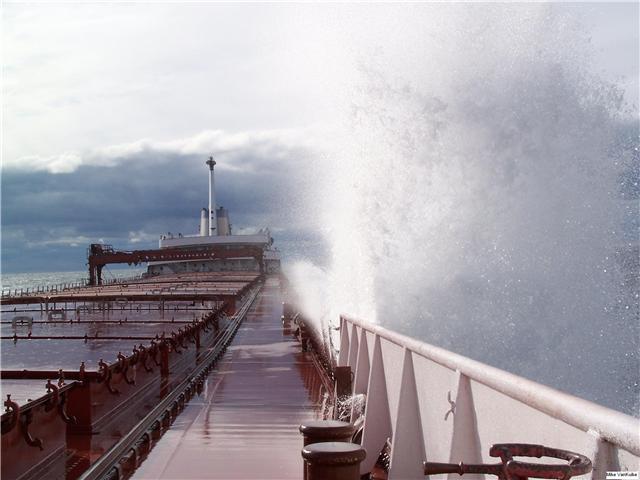

In other instances where we were taking considerable spray on deck during summer squalls like we had yesterday (9/3) comparable to the Ryerson photo, the holds were checked and rarely was there more than a trickle here and there.

Here is an image I found online of the Edward L. Ryerson taking some spray with what appears to be every other hatch clamp fastened. It looks like it was taken during the early 2000s there is a blue ring on the stack. Hard to tell what time of year it was taken but the cloud shadowing and lighting looks like the sun is at a low angle of either spring or fall. No photo credit information was attached to the image where I found it.
