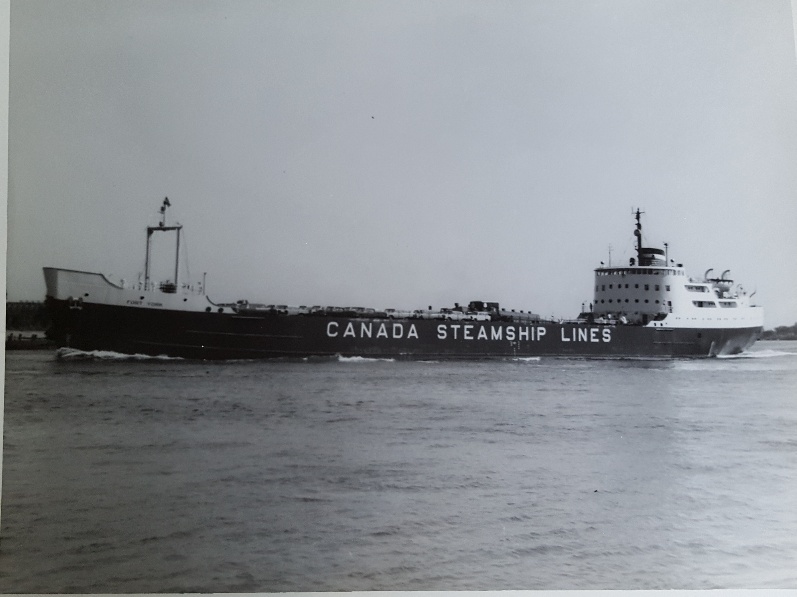

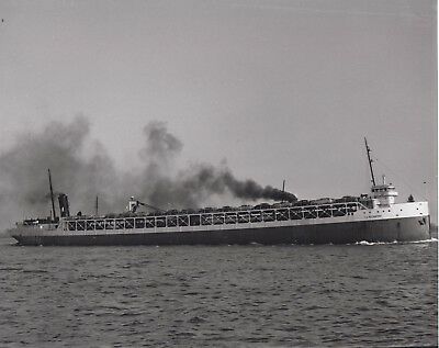

Here are some photos my father and I took of CSL package freighters with deck loads of trucks or autos.
We did not take the photo of the whaleback J T Reid but it is from my collection.
The photo of the T J McCarthy shows a more detailed look at the decking added to the spare deck and would lead one to belive it changed its stability from its original design.

Here is a photo from my collection that I posted on another thread recently of the Renvoyle with a nice deck load.

Guest wrote:How did the the bulk carriers modified into carrying automobiles handle after their conversions? It seems that the cars would have been considerably lighter than bulk cargoes such as ore, coal, stone, and grain these ships were originally designed to carry. Did these ships need any structural modifications in addition to the auto decks and ramps to operate in their new roles?
As mentioned by Jared, boats modified for car hauling were usually older and smaller boats. Some had extra decking added above the spare deck as the attached photos show. These boats also had limited horsepower which was common for boats in the 400' foot range unless they had been built for towing consort barges.
Even fully loaded with autos the freeboard was an issue in high winds.
In the case of the City of Bangor, the boat became unmanageable in the high winds and seas and due to the lack of hp, they were unable to maintain headway and their steering failed as they attempted to turn around and seek shelter south of Keweenaw Point.
