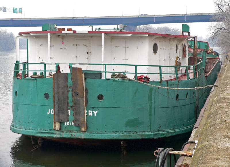

The 1st pic is Erie, PA, not NY.

Do yo know where in NY the photos were taken? Do you know who took the photos/where they are from?
Really appreciate all the help.
Troy, NY. Here is where I found the pictures at.
http://www.shipspotting.com/gallery/pho ... lid=150485
And here is a nice story about her work career starting on page 65. (Select pages under Telescope)
https://images.maritimehistoryofthegrea ... 4/data?n=4

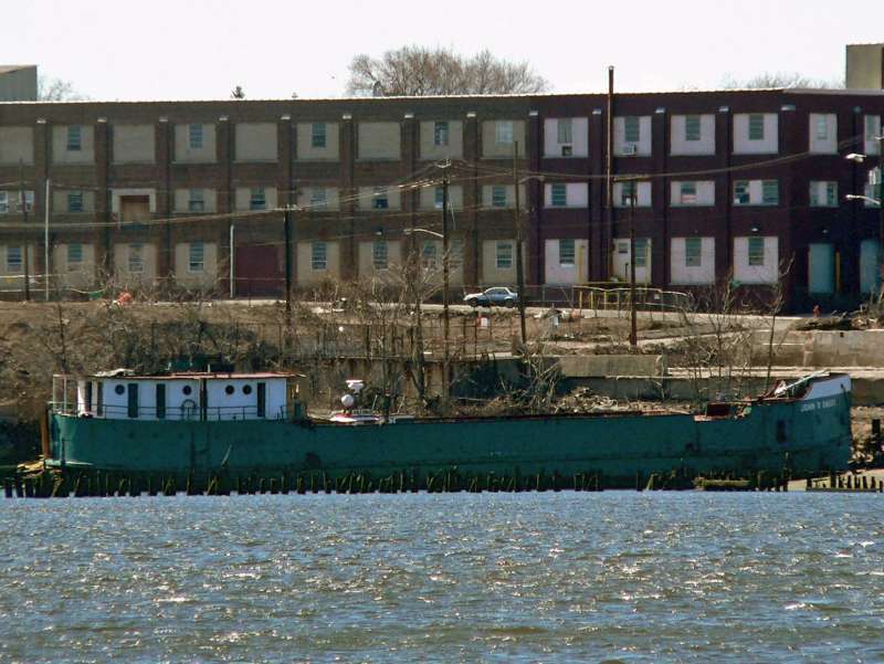

I think she was scrapped in the early 2000's. However there is a picture taken of her in 2005 in NY. The information provided hinted that she might be going down to Panama. However it looks like she was being dismantled.

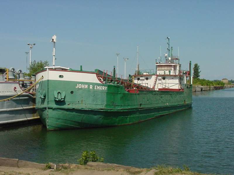

Hope someone can help me on this. During WW2, the Emery was a self- propelled sand–sucker dredge ship & frequent visitor to Wallaceburg, Ontario for deliveries of sand to local docks. I can get the basic data from the BGSU database at https://greatlakes.bgsu.edu/item/440290. From the this website and others (like Balticshipping, Vesselfinder ….) it seems like the Emery could still be in service. Still some info gaps I’m unable to fill.
Is the Emery still in service &, if it is, where?
What was the horsepower of the Emery’s engines during the WW2 years?
When the Emery was delivering sand to Wallaceburg, where did it suck the sand from?
How did a sandsucker work? Would the Emery have lowered the long pipe shown on the starboard side of the Emery to the bottom of Lake Erie, L St Clair (wherever the sand came from) and suck sand and water from the bottom and then pump the sand and water into onboard tanks where the sand was, somehow, “filtered” from all the water? How was the sand filtered from the water?
